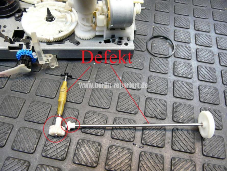

The accused gear are these:
Exactly what said by Quasipal in post #16. May be only one or both broken.
This is a guide (in German) for the same problem.
http://www.berlin-repariert.de/phili...mt-nicht-raus/

Edit: On mine, both appear fine, could it be the small crack that's visible on the last photo I posted? Also I forgot to mention that it started making a grinding noise when winding (but not rewinding), is that also because of the driveshaft?

Philips Turbodrive is really nice and simple but gears can split or cogs jump a tooth. So what I did was to take all the gears off for checking and cleaning then replace them in correct sequence using a manual I found online. I'd never even seen such a mechanism before but with a little care has it working like new. It was badly out of alignment with some parts smashed from forcing a tape but after aligning all the dots it was happy again.
Any cracks in cogs mean it is likely slipping under load so at least check for that. Sometimes cracks are hard too see if they are full of grease. Its the grease that makes them crack as it hardens the nylon.

The broken shafts fault is that videocassette is not laded or not ejected (locked inside VCR), because the shafts drive the lift assy (other than for threading the tape).
The grinding noise when winding (but in other case can happen also in rewinding) is due to the brake gears: the white round, placed under the two reel table (take-up and supply). Simply need grease in their housing, but to reach, firs remove the two reel table and the two main brake.
Sorry if my English is not good, but hope is enough clear.
