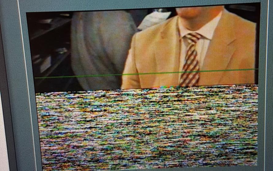

Here is a snapshot. Thanks for the quick reply - much appreciated.

Not overly useful. Let's try a sample clip instead.
BTW: You need to attach it to the forum post, not link elsewhere.

Clip attached. My capturing software wouldn't activate recording as the picture was so bad, so this is taken with a cell phone (but it looks consistent with what I was seeing on the screen)

Hmmm.... not thinking caps anymore. Head damage now looking more likely.
