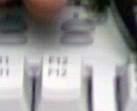

I would suggest pausing your analog digitization project immediately for like a week or sth until you get the time to to read and understand these concepts. There is no point in digitizing analog sources if you don't know what they are. You need to understand the difference between interlaced and progressive. your videos are 576i not 576p. Converting them to progressive, if necessary (for distribution... etc ), requires a "special" process (it is pretty straightforward once you know what to do).
your videos will look like this if converted incorrectly
