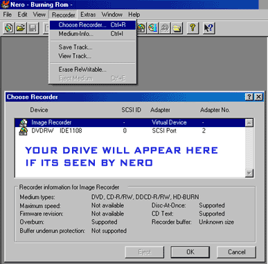

Burning-
You can download a trial of Nero Burning Rom 5.5.10.56 here (any 5.5.10.x version works well):
ftp://ftp4.nero.com/Nero551056.exe
It is the FULL VERSION, and I bet they'd still let you buy it.
Nero 6 has SERIOUS FLAWS when it comes to the DVD-Video templates, and just DVD burning in general. My new Pioneer 109 burner cannot use Nero 5.5, so I've been forced to switch to RecordNow Max 4.5, using a hacked driver from a famous drive/firmware hacker (flashman), which let's the software see the drive.
I've been talking with people for a month now on this problem, and conferred with several other pros that have just had to up and abandon Nero finally. It's just not very good anymore. They broke it. Version 5.5.9.x was bad too. 5.5.10 fixed it, but 6.0 broke it again. It's really random too.
I could go into other options, but see how Nero 5.5 works first. Install the demo and goto

Regarding Nero, I downloaded the referenced version from the ftp
site, however wasn't able to test it as I got the error, "Your demo
version has expired." (already closed). I had also just previously
downloaded a 5.5.10.42 eval version from http://www.oldversion.com/ and
had the same problem. Do you think Ahead is trying to force people to
go with 6.0+ for new purchases?
- mitch
02-22-2005, 07:15 AM
That sounds like you previously had a trial version of Nero 5.5.x on your system, and Nero sees this, and will not let you "re-trial" the software. You may need to scrub your system. Delete any "AHEAD" or "NERO" folder from you "program files" directory, and then scrub the registry for any "AHEAD" entries.
Even if the trial expires, you should still be allowed to purchase it.
Looking around online, it appears that the LG GSA-4082B not only works with Nero 5.5, but some of them may have even come with it (yours apparently did not, you simply got a different release, or OEM-retail/LG-retail differences). The LG GSA-4082B appears to be a nice old drive, easier to manage than these brand-new drives.
02-24-2005, 12:21 PM
mitch mitch is offline
Join Date: May 2004
Posts: 33
Hi. After taking a look at my registry (after uninstalling), I found
Nero items practically throughout, so after searching for another
possible way, I found that setting the date back by one year (2004) in
Windows fooled the eval version and I was able to access it! I went to
the "Choose Recorder" screen of Burning ROM and my burner was listed, so
I assume 5.5.10.56 supports it.
I went through the Ahead/Nero online order form (linked from the eval
version) all the way to the credit card input and nothing but version
6.0+ options were listed. I then found an E-mail address for U.S. sales
(us-sales@nero.com) and sent an E-mail requesting how I can purchase the
5.5 version. I'll continue to play with the eval version and get use to it.
- mitch
