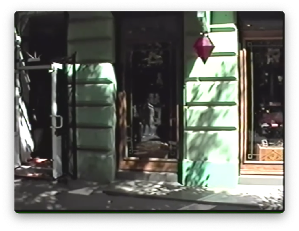

11-07-2025, 11:35 AM
tpaxadpom tpaxadpom is offline
Join Date: Jan 2024
Posts: 11
Also, please attach images to post -- do not hotlink other sites.
It's always interesting.
It's almost never impressive.
A lot of these "also includes" type TBCs are weak to do-nothing. This is a known known, and has been for decades. Every few years, somebody gets excited to discover that a device "also has a TBC", but then that conversation turns very quickly.
Receivers, like DVD recorders, simply are not TBCs.
No more than my toaster is a TBC.

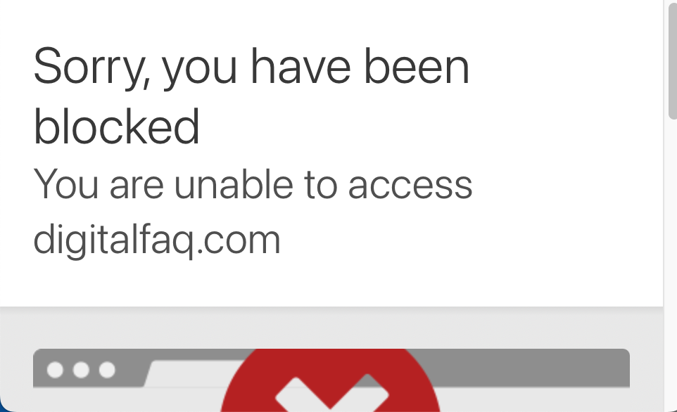

Uploading images to the site option is not working for me. When I select the file and click upload I get this error. "Sorry, you have been blocked
You are unable to access digitalfaq.com"
I have tried Safari and Chrome browsers. Link to the screenshot of the error message I am seeing. I am uploading screenshot in png format. The one I just tried was 78kB.
TBC on this receiver certainly brings some benefit and can be seen. The video is more stable for lack of better word, though additional boarders added to the image are not great. I can certainly remove them in post processing but it could introduce other issues. The best way to test would be to record some test patterns from test DVD on VCR and then play them for comparison purposes. I may get to it one day.
I understand your skepticism in relation to TBC bargains. LOL. It is just I haven't seen many discussion on TBC subject related to AV receivers. Is that because there is nothing to discuss or simply the area hasn't been explored... Looking up service manuals and chipset data sheets should not be difficult, but it doesn't gurantee the correct implementation was enabled in FW.
one of the 3 VCRs I have is doing a pretty good job of not showing any major issues that I could see without cherry-picking scenes and doing slow motion (frame by frame). The improvement would be visible if I was to make a short video but not possible to show on the still images (unless several images of each frame were taken and you were switching between them back and forth).
Here is the link to the sample screenshot with boarders added. Once again sorry for providing links to third party image hosting sites as I am having problems uploading images.

Hmmm. Looking at the image, I don't really see the boarders you're describing. The black vertical columns on the extreme right and left are considered normal for most SD formats as about 16 pixels of total horizontal space represent some of the horizontal blanking area and are expected to be there. The green line at the very bottom I suspect is related to some sort of head switching noise that the receiver doesn't know what to do with and most SD captures you'll find will have that to some degree, though usually it's more of a black and white static-like lower few lines.
Here's a bit of an example of what head switching noise tends to look like - would just look at the extreme bottom of the video frames:

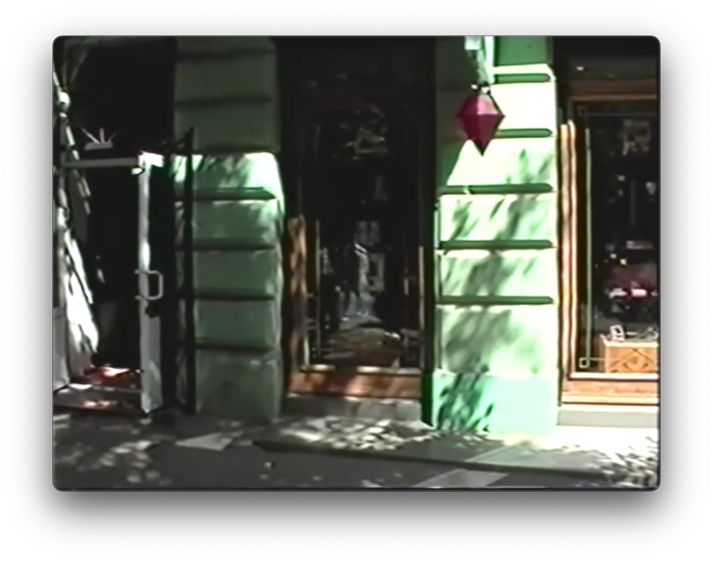

Here is the screenshot of the same video captured bypassing the receiver (VCR to capture card via composite video). There is no green line on the bottom and the boarders are smaller. There is static black/white line at the bottom though with the direct capture.
Using crop view in hybrid I have to cut 4 on bottom and 4 on the right side to get rid of black boarders on direct capture (cannot do odd numbers in crop preview). With TBC capture using receiver I have to cut 8 and 6 on bottom and right side to get rid of the boarders.
Another observation is when watching VCR through receiver on the TV with component video transcode done by receiver colors look more saturated. There is more noise in the video as well and I have to use more aggressive noise reduction on the TV. I am using Samsung TV to watch this on and it has "digital clean view" noise reduction. With composite video direct VCR connection noise reduction in low mode reduces all visible noise. It is impressive how well the vhs looks and TV doesn't have any issues with interlaced signal In order to achieve similar noise reduction results I have to use MC Temporal Denoise in hybrid set to very high.

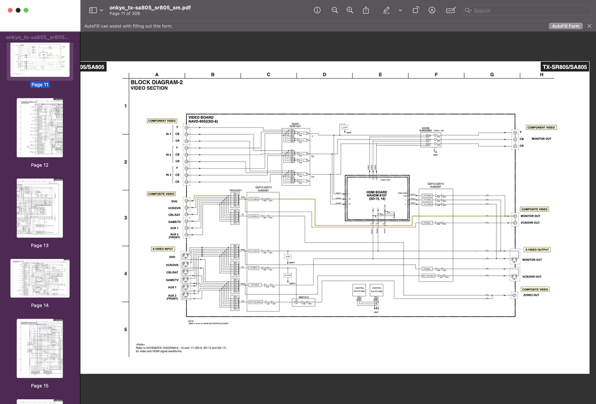

Onkyo 805 also has a bypass. Transcoding only works for Monitor out only, not other video outputs (at least that is what it said in the instruction manual if I am not mistaken, but it appears that video processing is still possible as there are switches for video outputs as well with signal routed through video processing board).
You can see how the composite and s-video signals are routed here at the high level.
