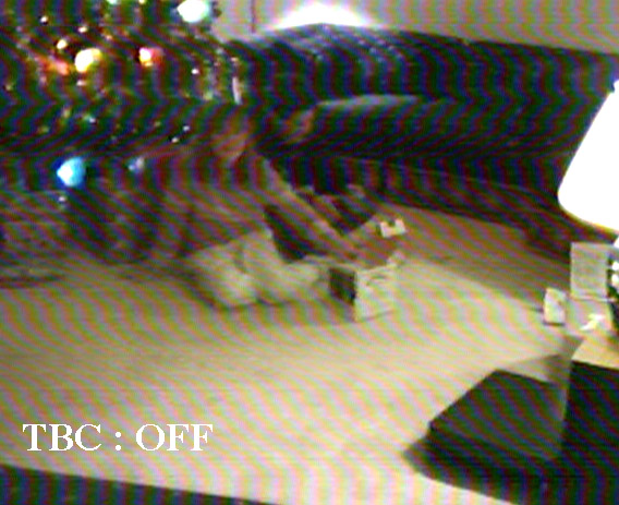

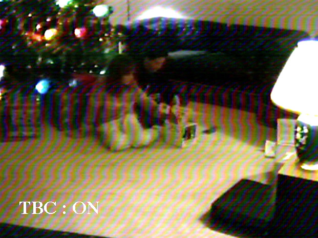

Last week though, the quality suddenly plummeted.
I've got these wavy-colourful-bandy lines running thru the image. Sometimes if I let the tape run for 30 min, rewind and play again, they disappear, but even that doesn't seem to be temporarily fixing the issue anymore. Also, when the TBC is engaged, the blacks get really, really plugged in. I've attached images so you can see what I mean. (I boosted the contrast of each image so the lines would be more noticeable on screen)
