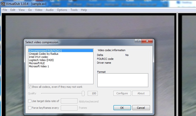

Installed 32 bit Virtual Dub ... and been using it fine for past 3 years.
However all the codes I normally use are no longer showing, if I load a file and the select full processing ... I should see all my codecs (Huffy, Cedocia, Lagarith, HQX, X264vfw etc.)
All I see are:
I have removed VD and downloaded new version.
Removed the codecs .... downloaded new ones, and reinstalled ......... still the same.
Any help appreciated.

Fixed it .... well so far looks like it.
Using the Nirsoft Installed Codec tool, I could simply disable & re-enable codecs without resorting to regedit.
There was a post on Doom9 I was pointed to for a similar issue and they found that vidc codecs were to blame.
I disabled all the vidc codecs and .... success all the expected codecs reappeared in VD.
(so they must have been installed correctly after all)
By a process of elimination found out that it was codec VIDC.RTV1 as soon as I disabled that .. all is fine (so far at least)
I have an MSI graphics card and this is an MSI afteburner codec, maybe it is faulty or it got installed it an update.
