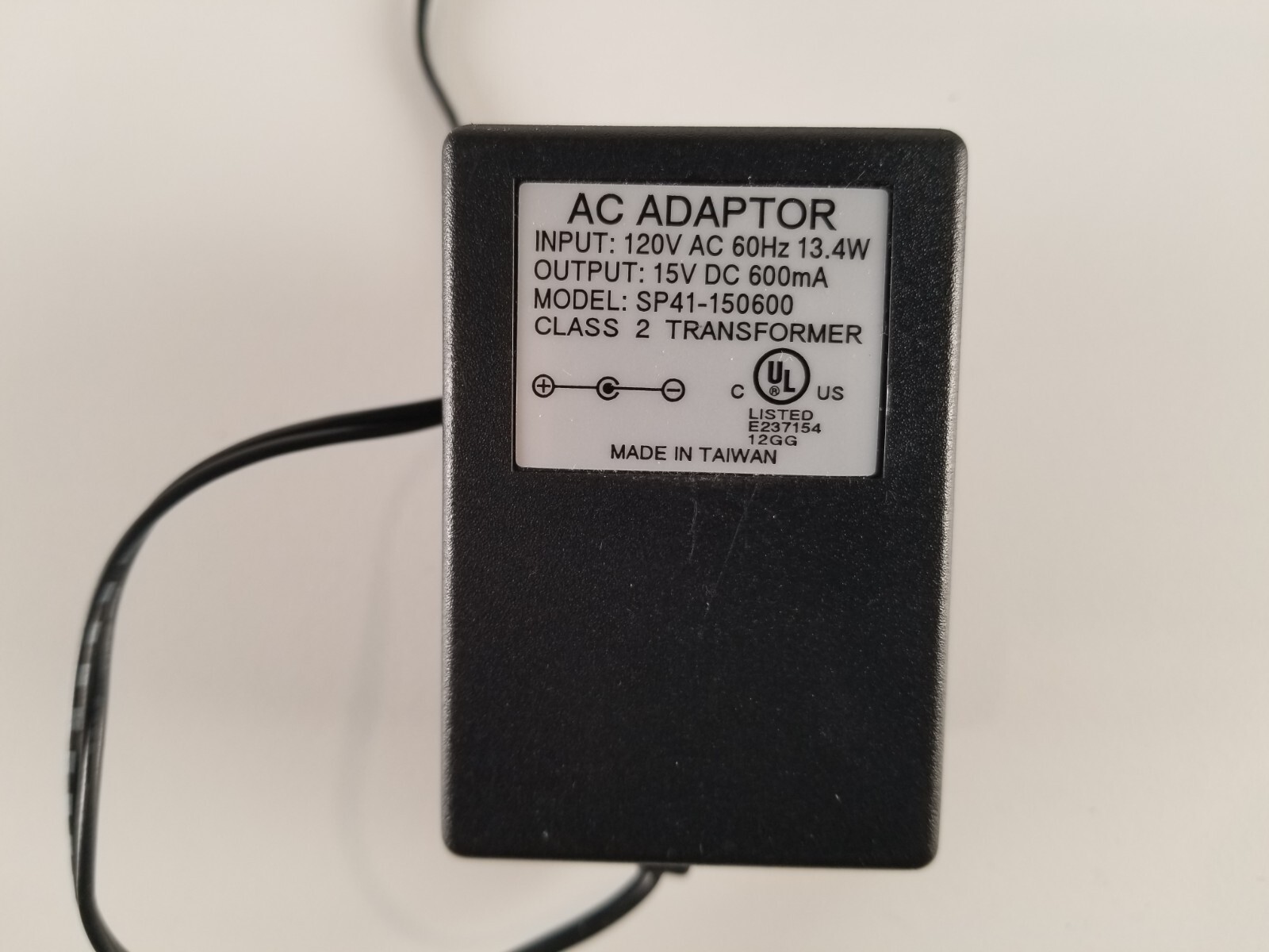

Hi, I was planning to buy AVT-8710, but I saw that it is US device which works on 120V input. I am from EU we have 220V input power here, any suggestion for some equivalent TBC like that one with EU current ?

But I would need 220V to 120V step down adapter, and in my local store I only find 220V to 110V. Because as I saw original AVT-8710 adapter have 120V input.

One more question on converter output is 110V - 50Hz, and adapter is working on 60Hz. Would that make any problem ? Will it convert to 60Hz somehow or ?
https://images.chipoteka.hr/image/ca...1155x1155.webp
https://i.ebayimg.com/images/g/DOcAA...Xm/s-l1600.jpg

Do not buy a step converter, it adds noise to signals. It's complete unnecessary.
Which exact unit are you using? Is it exactly a green AVT-8710? If so, you don't need any step conversion at all. It's not a "US device" whatsoever.
I can tell you exactly what to get here.
Just confirm exact model and version of TBC.
I'll even get you an EU-compatible PSU for my costs and shipping, and will even test it on my own AVT-8710 (or whatever TBC model it is) before sending out. I've done that many times for others in this forum (for EU, US, UK, Australia, Israel, etc).
Just to be clear, this thing: https://www.chipoteka.hr/adapter-220...0v%20converter
100% useless here. Don't buy that.

Green one it is AVT-8710. Don't know exact version didn't get it yet to check that.
I found a lot of adapter with 100-220V input and output 15V 600mAh but I couldn't find anywhere inner - out + pole on connector like original adapter has. I know you can reverse wires inside adapter, but if there is original adapter like that, that would be cool.

Lordsmurf how much is charger with shipping to Croatia ?
06-10-2025, 01:29 PM
At this moment, PSU is $22 USD, plus shipping calculated to an exact address (PM it).
My AVT-8710 power "kit" includes an inline power switch, which you really do want on these AVT-8710s. Just yanking the power cord is never a good idea (and does eventually lead to problems). All my current pieces are new, and the PSU is brand-name (not Chinese knockoff junk that spews noise).
I even have 1 extra on-hand right now, so there's no waiting time to send it, to whoever wants to claim it.
