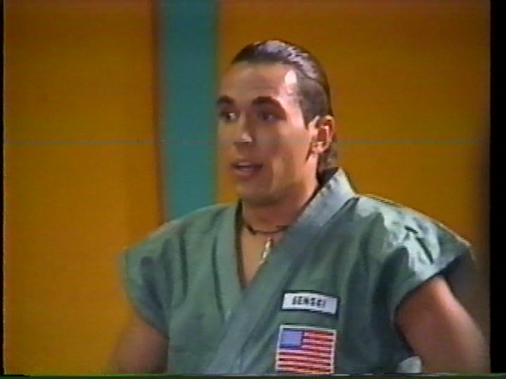

This comes from a DVD copy of a VHS played on apparently a very poor VCR.
Deinterlacing minimizes but the issue is still present, but it runs through the entire tape.

Camcorder color denoiser actually took the color away from the stripe, so in this scene and many others it is much less noticeable, but on opaque, single color title pages, there is a dark line where it was. I imagine this must be a very dirty VCR.
Will post my results.

I doubt that's a dirty VCR -- it looks like tape degradation.
What brand of tape was that? I doubt it was a good TDK, JVC, or 90s generation Silver/Gold/HiFi Maxell.
Was it a cheap Sony?
It's hard to tell if the grain is from a tape, or from a recording mode. If it's SP, that looks like a crappy Fuji tape.

One of the actors from power rangers sells this vhs on a dvd as a bootleg, the source tape was recorded and sold in EP. I noticed the disc was named dvdirect7848484 or something, so I imagine he plays the tape and presses record each time.
Camcorder color denoise took out the color, but there is still a dark streak. Neatvideo when properly takes care of it for the most part, but I might try out checkmate with avisynth and a few others youve mentioned.

Attached is with CCD applied, much better but there is still a slight dark line

Those chroma blips tend to only last a few frames at most. When watching the video, do you even see it anymore? I doubt it. I would even know there's a problem on that screencap if I didn't know the whole story.
Don't overprocess video in the futile attempt to make it perfect. Just make it better.

good news is this stripe (the middle stripe i'm talking) is only present on UV, bad news is it's on all frames so good luck to get rid of it.
Now that i think about it maybe some kind of delogo filter would do it, it's not gonna be a piece of cake no matter which way to take the stick.

looks to me like the source VHS has a crease in the tape, probably played it in a shitty deck with a bad pinch roller.
ive had a few tapes like that

Camcorder color denoise will take the color away, but it leaves a dark line. Using neatvideo, it will fill it in at the expense of detail. I will try this this weekend and report back.

CCD removed the color from the stripe, neat video sampling the dark part blurred it away and it looked fine and took out the noise that i needed to take out anyways.
