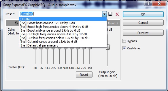

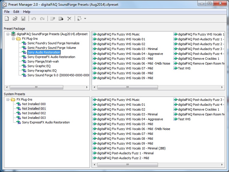

Thank you. I have downloaded the Presets manager and dragged the presets (except for the top 2 and bottom, Normalize and Volume as well as Sound Forge 9.0, since I have Sound Forge Audio Studio 10.0 and these just cause it to crash).
However when I've dragged them down, they register as "Not installed", except for the SonyExpressFX Audio Restoration. Indeed, in Audio Studio the only presets that I can choose from the FXFavorites - Sony menu are these ones... The others (Flange/Wah-wah, Graphic EQ, Paragraphic EQ and Audio Restoration) have evidently not installed.
Any suggestions?
The Presets manager
And an example from the menu in Audio studio:

I think Sound Forge Pro is required for some filters.
