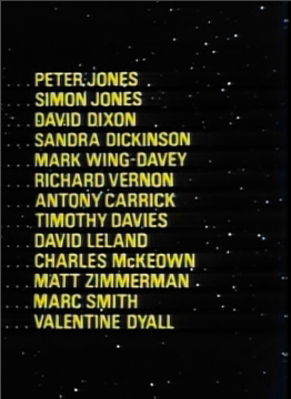

  #112
11-16-2014, 12:34 PM
jriker1 jriker1 is offline
Join Date: Oct 2014
Posts: 68
I don't see any streaking or bleeding.
Maybe a terminology thing or a different monitor thing, however you don't see the yellow coming out to the right of the text and all the way to the right side of the picture? Note on my LCD, I can't see it if I look directly at the computer monitor but if I look on an angle can see it in the attached picture.
JR
  #113
11-16-2014, 12:37 PM
I see yellow text on crisp black background. My monitor is calibrated IPS.
  #114
11-16-2014, 04:54 PM
How was the picture made? It's kinda small for working. Actual size cut directly from the video?
Chroma smears and ghost trails, not to mention some halo, and blue stain at the right border. You'll also see lighter bands of dark gray noise at the top and bottom (2X blowup, Gamma raised 36%, midtones +10% with gradation curves, so the effects are highly exagerrated):
Depends on how the posted image was made. The ghosting in the original image measures only 2 RGB points lighter than the darkest blacks, the blue measures only 4 RGB points over black. If you find that easy to see on your PC monitor, your monitor is too bright and gamma is too high and uneven. If you find it even easier to see at an angle, you should be using an IPS or similar monitor instead of plain-vanilla TFT.
Stuff like this is difficult to catch in a still image, even if most viewers will never see something at RGB 4 on their TV -- it would all look black. People who use their TVs in "torch mode" as well as oversaturated, which most people do, would never see it because blacks are always crushed at factory settings.
This is rather common with VHS and with TV movie broadcasts. Sometimes it's the player, but more often it's the source. A few seconds of video would be much better than a still pic. Anyway, filters that can help with it are usually time-based and won't work on single frames.

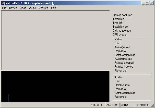

I'm pretty sure teal-colored options are selected there. You have "Video mute" highlighted and "OFF" is highlighted in the same manner, hence "Video mute" is off.
You can test this by tuning to any analog channel. If you see static that should mean it's off. If you change it to On you should see a blue background on each channel instead.

VDub capture settings might have something to do with it. Look at "Capture" -> "Timing...".
