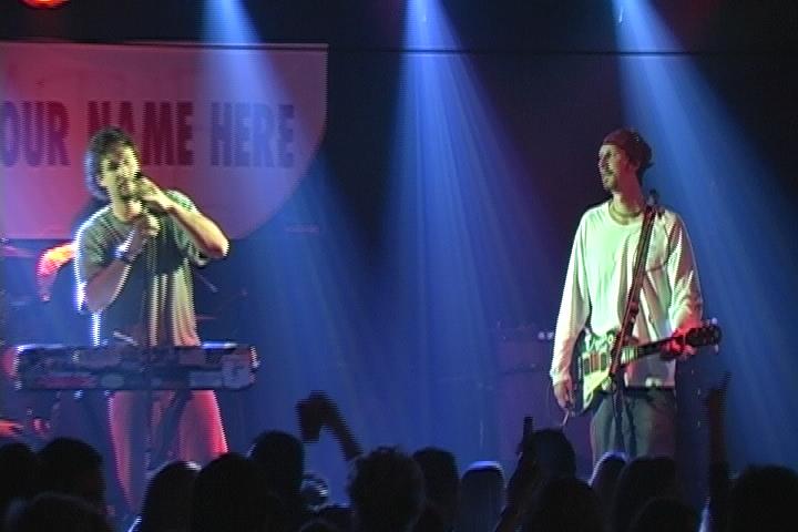

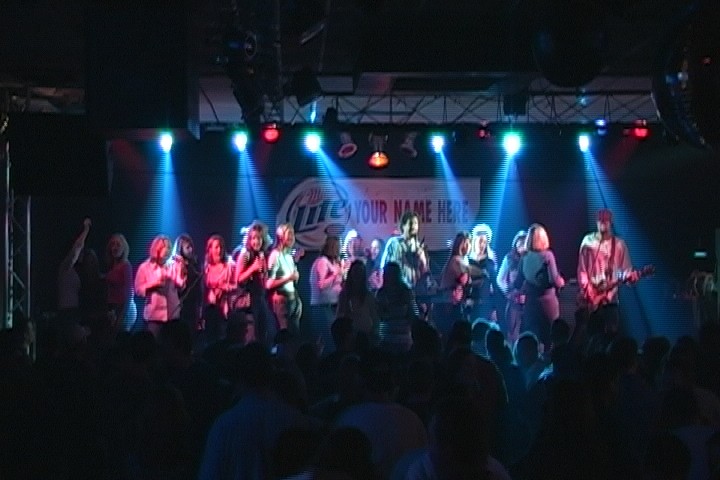

DV source is lossy encoded video to begin with.
Yes and I didn't say it wasn't, it's irrelevant to the discussion about my samples ither than the quality of the encoded capture.
Using the high quality DV as source is not ideal but if you wanted to make true comparisons you'd want to do something similar. Perhaps add some noise and some shakiness to further simulate a typical home VHS.
You're really missing the point, if I had your capture device we can then capture the same video over s-video using uncompressed. Now we can compare the Canopus capture, the uncompressed capture and most importantly we can compare them to the source. You can't do that if your source is VHS.
In any event someone asked for some samples and those are really the best I had as it pertained to this discussion because you can compare to the source. I can post VHS samples all day long but without something to compare them too it's kind of pointless.

The canopus can copy DV directly via firewire or capture over analog, so he is not in the wrong.
Just so it's clear the transfer of DV to computer that produced image 1 was directly over firewire to the computer. The Canopus does have firewire on the input/outside side but I never used it. Not sure if reencodes DV or just passes it through but if I were to guess it just passes it through.

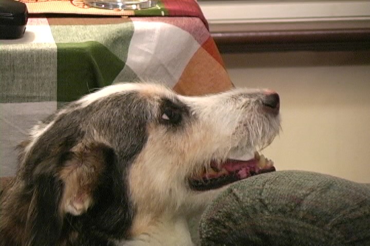

The GL2 is a mid range camcorder, you're not going to get this from a VHS camcorder.
This first one is deinterlaced:
